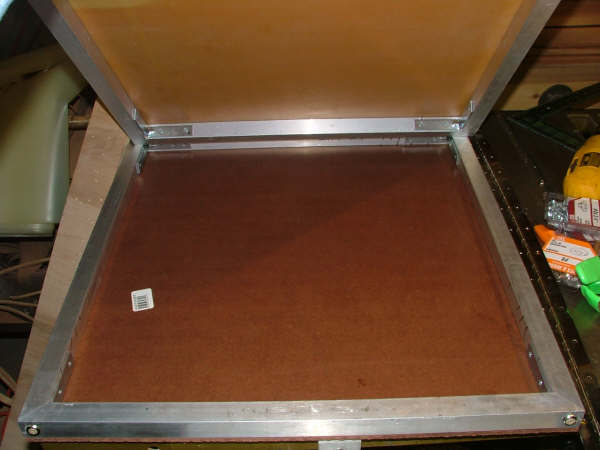

Here is mine
Made by Don Williams.

Lance...very cool set up. Is the bottom just tempered hardboard? Aluminum Frame? What kind of rubber sheeting?
Brad
Avon, OH

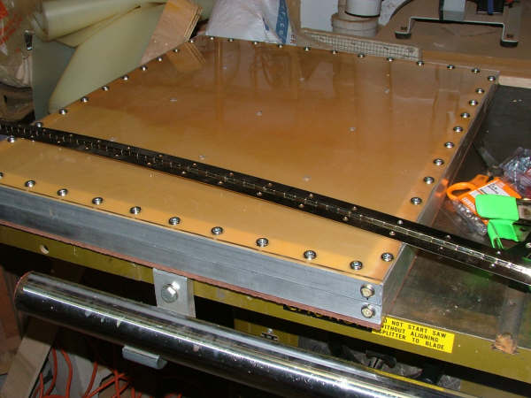

Lance,
What are you using to seal the two halves of the frame? I have been
trying to build a frame press from wood and it's been leaking. After
many hours of caulk and duct take she's only holding about 5Hg.
I've been thinking about aluminum or HDPE for my next go.
Louis

I've used a lot of vacuum seals, o-ring stock workes pretty well, but by far the best seals I've used have been from a company called Torr Technology. www.torrtech.com/Pages/Silicone-Seal.htm
Expensive but bomb proof.

Ill wait and let Don comment on this, he is the designer
